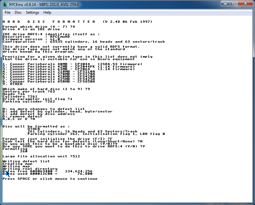

To create the blank 128MB hd4.hdf file, I performed the following steps :
Followed the article called Installing RPCEmu and RISC OS 3.71 on Windows at
http://www.4corn.co.uk/articles/rpcemu371win/
This installed a fresh copy of RPCEmu 0.8.14 with a universal boot sequence running off HostFS.
After rebooting with this setup, the icon bar showed a hard disc 4 icon and looking in the RPCEmu directory, there was a file called hd4.hdf of zero length.
In the Utilities folder, there is !HForm so I ran this.
It asked which drive to format so I chose 4. It said the drive wasn't formatted so I chose option 9 to specify my own drive format parameters.
I entered 63 sectors per track and 16 heads.
To calculate the cylinders for a required drive size, there are 63 * 16 * 512 bytes per cylinder (sectors * heads * bytes per sector) which is 516,096 bytes. For a 128MB drive, this is 128 * 1024 * 1024 bytes = 134,217,728. Dividing one by the other we get 260.06349 and a bit cyclinders so we round this up to 261.
I therefore entered 261 cylinders at the prompt.
The next question was the drive parameter init flag. I don't know what this is so I left it at 1.
I entered 262 as the parking cylinder (but this I guess could be anything for a virtual drive).
I then entered A for no more changes to defect list, F to format the drive, N for no soak test, Y to make the drive bootable followed by Y to finally format the drive.
Once the drive was formatted, I entered a large file allocation unit of 512 and the process was finished. See the image below :
After clicking back to the desktop, I could then check the free size on the hard disc 4 and it came back with Free 128Mb, Used 75K, Size 128Mb.
Any more questions, please ask.
